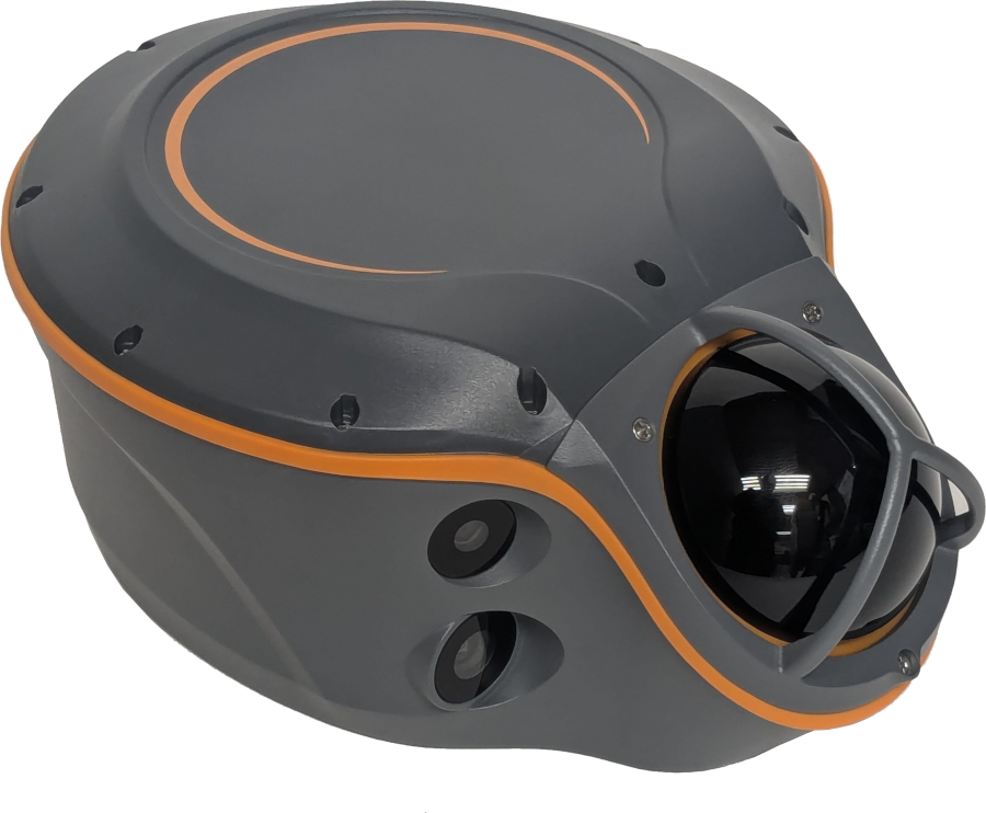

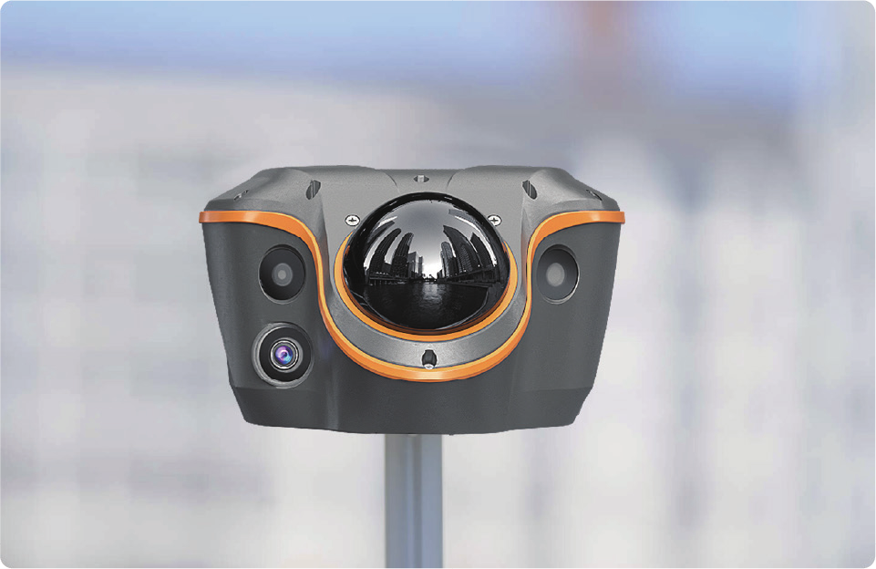

The CHCNAV ViLi i100 is a full-constellation RTK GNSS rover with integrated 96-line LiDAR scanner, 8 MP telephoto camera, dual color cameras, and a 200-Hz IMU.

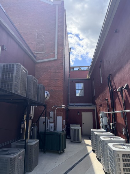

It is built to hold accuracy where conventional GNSS receivers fall apart: narrow alleys, under viaducts, dense urban canyons, under eaves, and tight construction corridors. It achieves this by integrating IMU, Visual SLAM along with GNSS positioning.
SFix 2.0 engine maintains accuracy within a 20 m radius of initialization in fully GNSS-denied spaces using LiDAR and SLAM.
Vi-LiDAR contactless survey: take one photo with the 8 MP telephoto, extract multiple 3D points per shot out to 15 m.
Real-time 3D point cloud earthwork - cut/fill volumes computed on-site in LandStar with no rod contact required.

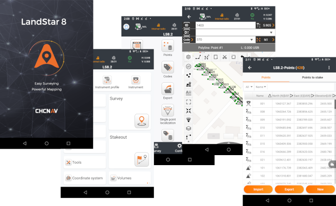

LandStar field software runs the conventional RTK workflow, the Vi-LiDAR contactless workflow, the SFix obstructed-area workflow, the AR visual stakeout workflow, and the on-site earthwork volume workflow on the same data collector. One field software, one rover, no total station to switch to when the sky disappears under canopy or inside buildings.

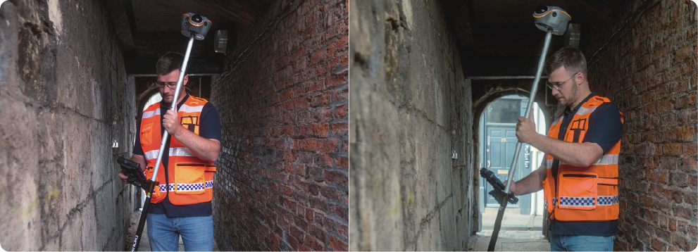

SFix 2.0 Engine and the GNSS-Denied Workflow
SFix 2.0 earns its keep on the jobs where RTK failed in the past. The 96-line LiDAR captures 860,544 points per second across a 360° × 90° field of view at 30-meter range, and SFix 2.0 uses that data with SLAM-derived angular constraints to reconstruct the rover position.
Continue to use the receiver in GPS-denied environments within 20-meters of SFix 2.0 initialization. Beyond 20 meters the error grows roughly 3 cm per additional 10 meters.
Multipath-affected signals are filtered automatically by real-time satellite path analysis, eliminating the false-fix trap in obstructed RTK work. The receiver does not silently degrade or jump; it holds a real-fix aided with IMU and SLAM.
SFix supports a seamless handoff from open-sky RTK into obstructed work, and tilt compensation extends through the full 0–360° range in SFix mode (0–60° in conventional RTK).

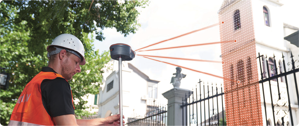

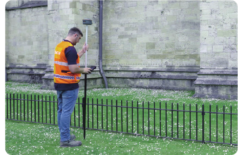

Vi-LiDAR Contactless Survey
The Vi-LiDAR workflow uses the 8 MP F/2.2 telephoto camera and the LiDAR together to extract multiple 3D coordinates from a single photo. Aim the receiver at the corner, the curb, the gas valve, or the fence line, take one shot, and pick points off the resulting image - each pixel resolves to a coordinate in the project CRS. ±5 cm (0.16 feet) typical accuracy at 15 meters, with an optimal imaging range of 5 to 20 meters.
In practical terms, eliminate pole-on-the-point work for any feature the operator can see and photograph. The surveyor stands in a safe location, photographs the feature, and picks the points.
For batch capture, one shot can produce many points: corners of a building face, individual tops of a fence row, all four corners of a manhole, cracks along a pavement edge. The crew shoots once and picks many - significantly faster than rod-on-the-point work for feature-rich captures.

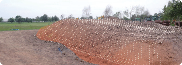

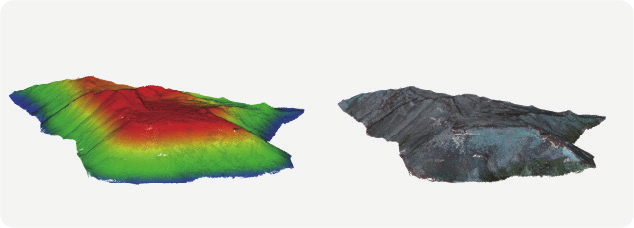

Real-Time 3D Point Cloud Earthwork
Stockpile and excavation volumes are computed on-site in LandStar from the live point cloud. Walk the perimeter or scan from a fixed setup, define the boundary on the data collector, and the cut/fill volumes are returned.
This is a non-contact volumetric workflow. The operator does not need to walk the surface, plant rod shots across the pile, or set up a drone flight - relevant when the material is hazardous (contaminated soils, unstable scree), when the surface is unsafe to traverse (active dump faces, soft fill), or when the schedule does not permit shutting down equipment on the pile.

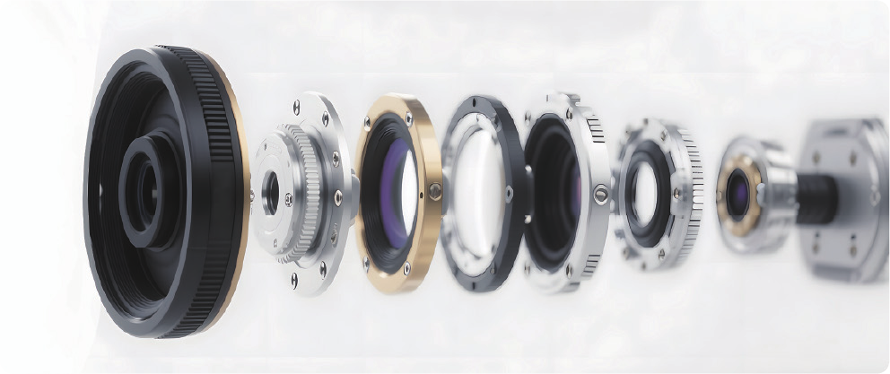

The ViLi i100 carries three cameras with distinct purposes: a forward-facing 8 MP F/2.2 HD telephoto for Vi-LiDAR contactless survey, dual forward-facing 2 MP wide-angle color cameras with 130°(H) × 46°(V) combined FOV for full-color point cloud colorization, and a 2 MP 90°-FOV bottom-facing camera that drives AR visual stakeout.

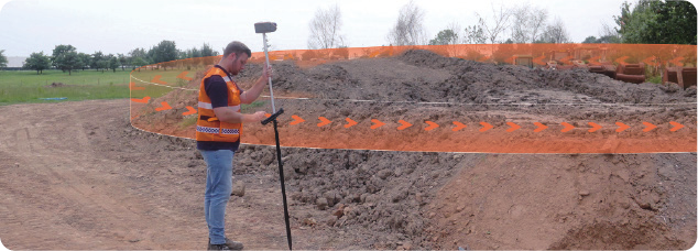

AR Visual Stakeout
Vi-LiDAR captures one photo with 800,000 LiDAR points making it possible to extract multiple 3D coordinates instantly. One photo, unlimited targets; no pointing, alignments or steady holds required.
Accurate, non-contact measurements are possible from a safe distance.

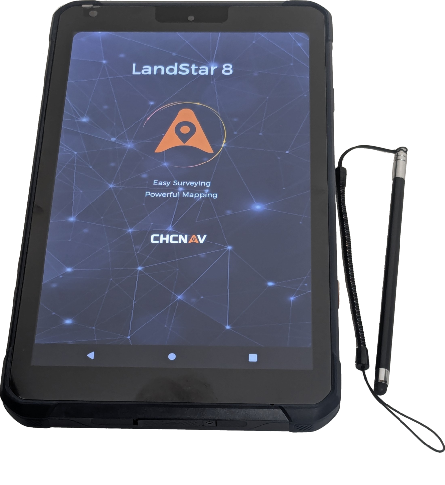

Software: LandStar 8 Field Software
LandStar runs the full ViLi i100 workflow on Android: conventional RTK, Vi-LiDAR contactless survey, SFix obstructed-area positioning, AR visual stakeout, and on-site earthwork volume calculation in one application. The operator does not switch apps to switch workflows.
Firms that already run LandStar on CHC GNSS receivers will find the same workflow and project structure carry over.
The full Vi-LiDAR, SFix 2.0, AR stakeout, and on-site earthwork workflows are LandStar-specific - third-party field software does not drive the visual or LiDAR features.
If your firm's existing workflow is built around a different field application, evaluate the LandStar workflow before ordering. You can do a full evaluation using these detailed [ instructions ]. Call us and we can help you with your evaluation.

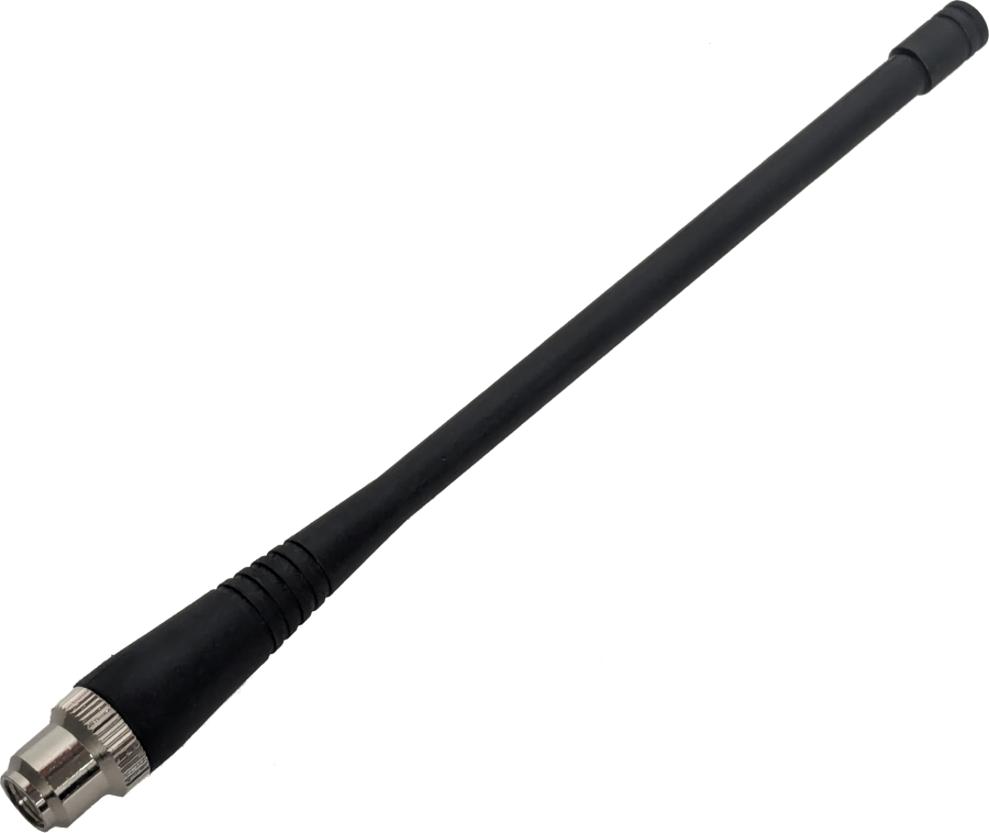

Built-in UHF radio 410–470 MHz, receive-only
Protocols: CHC, Transparent, TT450
Data storage 64 GB internal (~1 h scan or 30 h point cloud), expandable to 1 TB
Ports 1 × USB 3.0 Type-C (data download), 1 × UHF antenna (SMA male)

If cellular service is not available, a local base can broadcast UHF corrections to the i100. The SG7 and eBASE are both good choices for a local base because they support static and APIS/RTK corrections:

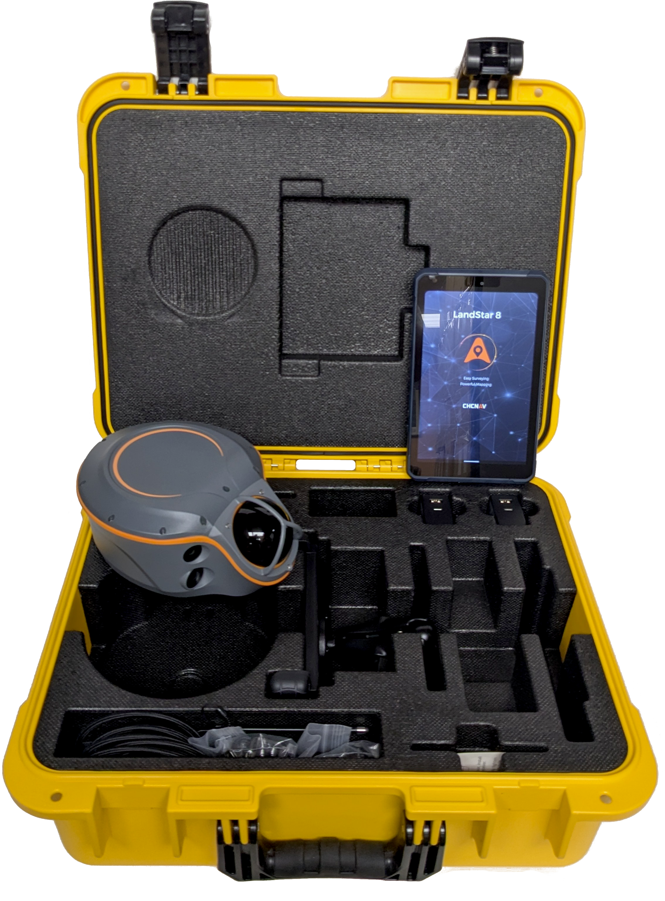

Kits include:
  • i100 Main Unit
  • LT800 Tablet

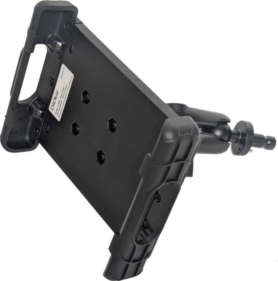

  • Tablet Mount + Bracket
  • SMA UHF Antenna

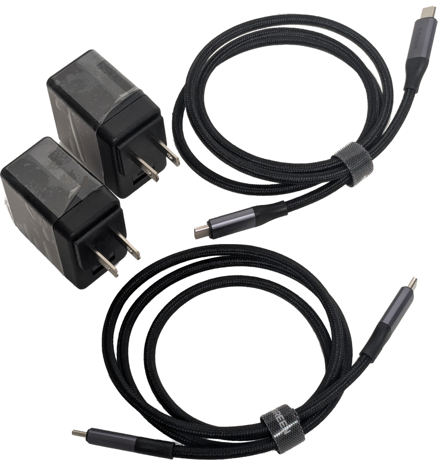

  • Charging Cables
i100 Kits
i100 Standard
$ 19,900
What's in the case?
The i100 kit is a complete system and includes a tablet with licensed field software.
Carry Case Contains
i100 body
LT800 Collector Tablet
SMA UHF Antenna
Tablet Mount
Data and Charging Cables
